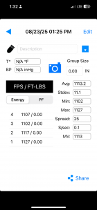

Or we can just read @Bowhunter41 last post answering my question about his chrono data from the weekend.
His chosen load at 24” expected velocity 1050 netted 1250 in a 16”, and where have I been saying to start expecting a drop of in muzzle velocity, around 22 -24”. If he has a 24” rifle it would be nice to see how that load compares to the book.
Spoiler alert. I have 12” barrel that is faster than half my 16” barrels and very close to a couple 18”. So if I need to game the system to get the results I want. I certainly can.
Back to my original post, you really won’t know until you shoot the load.
