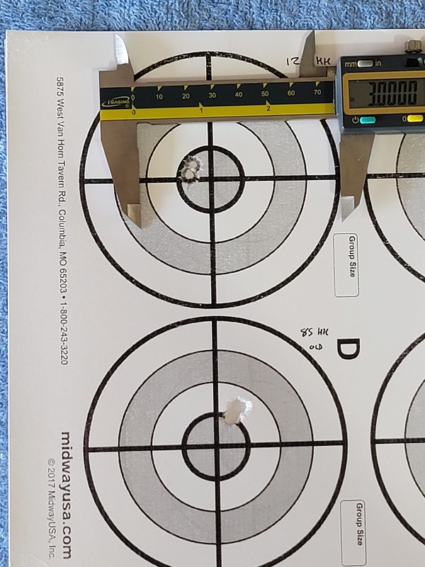

124gr HH on top. 85gr HH on bottom. 3-shot groups @100 yards.
