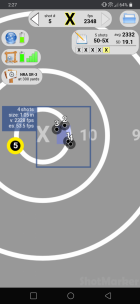

25 grains of Benchmark with 55 grain Varmageddons will shoot 1/2 MOA at 200 yards out of my Mossberg MVP.
Disregard shot 5, big gust of wind as I broke it
