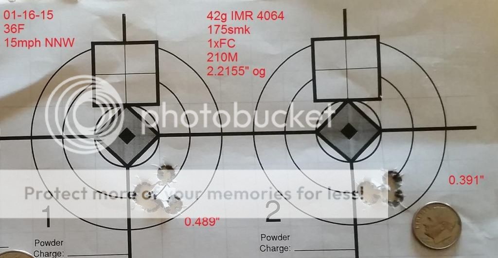

Not sure about the 180's but 42g IMR4064 with 175smk shoots sub 0.50" 5 shot groups all day long and chronos at 2646fps out of my 5R 24" barrel. 43.5g with the 175smk chronos at 2768.
Recently installed a new scope on my 5R, laser bore sighted at 50yds then zeroed at 100yds with this load then shot a few groups. Accuracy was same as always.
Wow, this is good to know. How long (OAL) are you loading your rounds with the 175smk?

Sorry but I don't measure COAL as it is so inconsistent from bullet to bullet, I measure off the ogive. This load is seated to 2.2155" Ogive using Hornady bullet comparator gauge with digital calipers. Pretty sure COAL is in the 2.805-2.810" range but don't hold me to that as I don't log COAL data.
My AR10 loves 42.4g H4895 with the 175smk and that same load shoots very tight groups in my 5R but its slower than my 4064 load. 42.4g H4895 chronos at 2587 in 38F temps. I'm currently looking for high node with H4895/175smk for my 5R. I need it to be in the 2675-2725fps range. I regularly shoot out to 1100 and want as much velocity as I can get within reason while staying accurate to help minimize the wind factor as much as possible.
Padom,
Good shooting. I believe those are very nice groups considering they are from an AR-10 in 15mph wind. I'm impressed.
