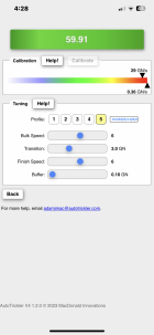

With the attached (post updated) H4350 profile and the Ingenuity Precision finisher I’m getting about 13 sec per throw and few or no overthrows. I loaded 100 like this yesterday. Wondering if that’s about what others are using.
Bulk 6
Transition 3.0
Finish 6
Buffer 0.10
Bulk 6
Transition 3.0
Finish 6
Buffer 0.10
Bulk 5
Transition 2.0
Finish 2
Buffer 0.08. With I.P. and H4350
Bulk 5
Transition 1.5
Finish 6
Buffer 0.04
