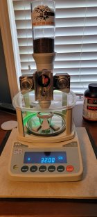

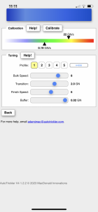

On the sliders at the top, the fast and slow are both out of the sweet spot and running fast on this setup.
This is due to me using a shim (piece of primer box) under the back leg of the auto gizmo. I will need to get a thinner shim.

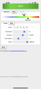

This is the setting I have been using for H4995. Out of ten throws, I got 2 overthrows. I could slow it down a little and avoid the overthrows but prefer not to.
I may tweak it a little more, but this works well for me.
