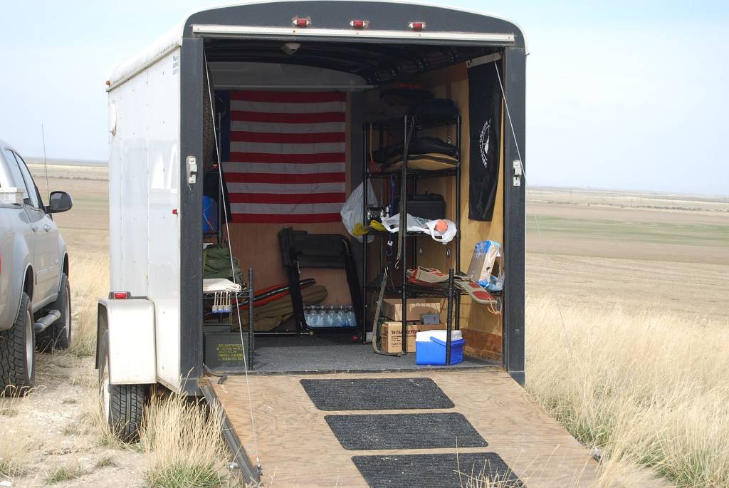

For about 15 years one of us hauled an enclosed box trailer that held the gear for four of us in the field; benches, rifles, ammo, sun shades, the whole kaboodle. Secured shelves were added for extra wall storage. It had 15" wheels and 8-ply tires. Keeping all our gear out of the weather and out of sight was another added perk. It worked out great when we had a place to stay while in the field, but now we all haul travel trailers and camp on ranch property....about as good as it gets for us and what we do.

Could I suggest making the top of an enclosed trailer into a platform for a shooting bench and observer's chair. I've had my 8' P.U. bed with 2 benches that swing 360 and a spotter's seat. Our bench's are home made but full swing benches are available. We are gopher shooters. Big tires and bearings are a real plus, careful with the 'Bearing Buddies', don't overfill and blow the grease seals, grease sparingly. If shooting off the trailer a 'tongue jack or 2 on the rear may be beneficial. I found and bought the trailer you need, it's about 10' X 6', big wheels and bearings, well cared for, near new tires, and 2" hitch for $1000. Check Craigslist, this trailer was 70 miles away, BUT.

Anyway yeah, I think a good used uhaul would be great. I could just spend some time outfitting it to suit a single purpose for the most part. It'd be pretty sweet and I could just keep everything in it without loading and unloading every time I go to a match, as well as at the match as lots could just stay in the trailer. Absolutely unnecessary luxury item is all it'd be and only because I can't begin to justify a million dollar motor home. Lol! Height would be a biggie to me as well. Gotta be tall enough to walk around comfortably inside.
