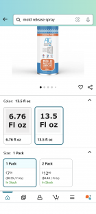

Try again...
I'll order one of these for a trial run unless anyone has tried and not liked the results.

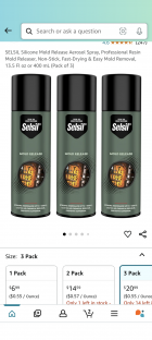

WARNING:
TRIED A TEST RUN...THIS STUFF DID NOT WORK AT ALL.
