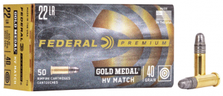

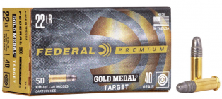

I was just on the Federal website, and it looks like they are manufacturing 22lr match ammo here. The have HV and standard vel Gold medal. (made in USA on the box)
Mike
