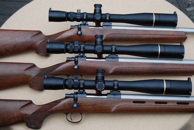

All my rat rifles wear Leupold's. Over 60 years I've tried others and have always come back to Leupold. All my 223 HB varmint rifles all wear Leupold VX3 6.5-20X LR 40mm with the M1 elevation turret, as I'm a dialer. Just some Cooper's shown, there's more.

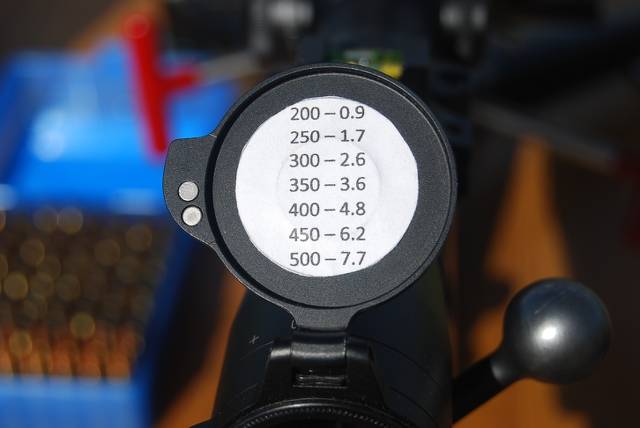

With a laser rangefinder, good dope from a ballistics program (Sierra Infinity for me), first shot hits out to 600 yards is entirely do-able on a regular basis. I put my come-up chart on each scopes ocular flip cover for instant corrections in the field. Hold dead-on after dialing, allow for wind and shoot. Works great with the Alumna alloy magnetic flip-covers. Good glass is imperative looking through a scope for hours. Eye fatigue is a real bummer. Good glass costs for a reason.
Had this pic handy. It's the come-up chart for my 20VT in MOA. One for every caliber/rifle:
