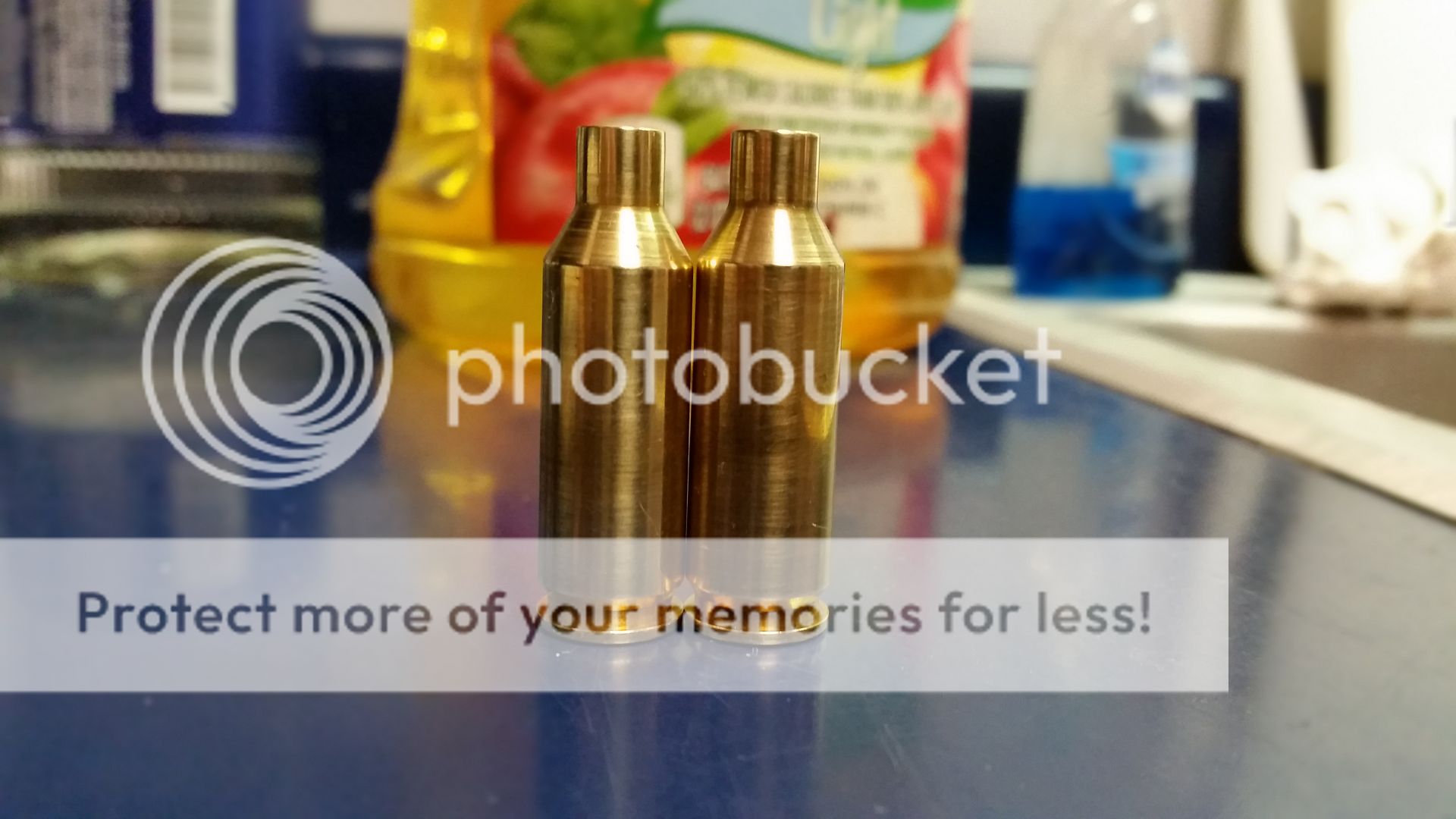

HOW BOUT POSTIN PICS,OF THE CASES.SOUNDS INTERESTING.
Pics as requested.....BRX on right, my baby on the left.
