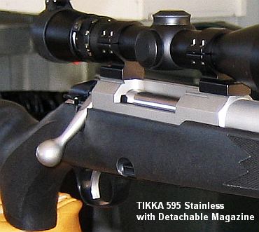

Here are some thoughts on specifications.,Note: these are just some initial ideas. Plainly we are a LONG way from setting anything in stone. The big question is the action. Here is a super low-budget proposal using a Tikka 595 with factory trigger. This could bring you in under $1500.00 complete with Scope!)
Scope: Weaver T-24,$365) or Bushnell 4200 6-24,$420)
Rings: Burris Signature Zee,$30)
Stock: MBR-Style,or maybe LowRider), inletted,$275)
Action: Tikka 595,1-lb std trigger),$450 for donor gun, $350.00 net)
Chambering: 6mm BR Norma, .272" neck,must chamber factory ammo).
Bbl: Krieger 8-twist, .236" 4-groove, 6mm, #17 contour, prefit,$400.00, deep-chambered and threaded, but not final-headspaced)
Required gunsmithing: Set shoulder,$60)
Pillar bedding: Optional. Glue-in allowed.
All-up weight: 7.5 kg,16.5 lbs)
Barrel length: 700mm,27.55") max
$1480 complete,as glue-in, with T-24 Weaver).
About the action--I've talked to Mac about the 595 Tikka. He says the factory trigger can go down to 1 lb. no problem. The 595 has a built-in recoil lug. He says they are very square and do NOT require extensive "blue-printing". He usually just faces the receiver, but he says that's not really necessary. Re headspacing, he says normally a pre-fit barrel will work fine if they are left .005" short and a smith does just a little measuring on the shoulder. The problem is availability. The 595 is no longer in production. But you can find donor guns for about $450. Sell off the barrel and stock and you've got a $350 action/trigger.
NOTE: The 595 may not really be viable because it's no longer in production, but it has many nice qualities. It's very square and stiff. It has a tri-lug bolt with light bolt lift. Very good magazines are available for anyone wanting a mag-fed version. Mac says you can get the trigger down to 1 pound reliably. With a good mag, the barreled action could be removed and placed in a different-style stock for HighPower competition.
