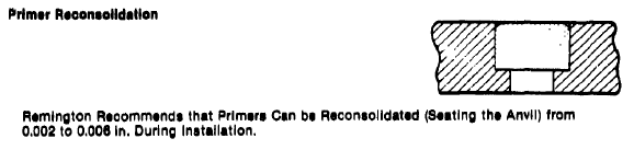

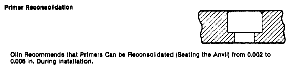

That post was good, thanks for sharing it. I think I'm no the right track now. I'm hoping Sunday or Monday, (a couple warm days here) whichever day has lower wind, will go shoot some tests. All my load development has been with flush primers, and I'll use that as my Control group, then go .005, .008 and .011 and .014 seating depth from the case head. I think my "0" crush will happen at .008, and I'll be about 3 thousandths crush at .011, and 7 thousandths crush at .014, if I'm doing my math right. I'll check when it's not 2:18 am!

For this post, crush is that feeling after you feel the primer hit the bottom of the pocket and then adding more pressure to seat the anvil:
