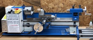

I do something like that with my cheap Chinese mini lathe. My way is a little more crude than yours but it works.
