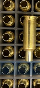

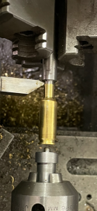

I made a few mods to my set up.
I cut a relief on the cutter to only contact the shoulder the wursts I wanted
I cut a nub on the pusher anlittle under the primer pocket diameter. This allows the pusher to push flat on the base.
I think both mods made it more consistent
Also just take 1 pass with a faster feed rate.

I have seen some very interesting post on this subject, but my main concern is why.
1. No heat. The cutting action doesn’t generate enough heat to affect the mandrel
2. No lube needed. Just graphite the ID of prepped brass and push them on.
3. I use the same size mandrel as I use to expand the necks for reloading.
4. After cutting, my brass is ready to load. I used a set straight off the lathe in the Nationals last year
5. For me it’s quicker than using my KM by about 50%. That’s for the cutting. Factor in they are ready to load - no lube clean up or resizing it’s even more of a time saver
6. Very consistent results. Since the brass to mandrel is an interference fit the diameter is spot on every case. Not sure but assume the interference also pushes any excess to the OD to be cut. The mandrel doesn’t heat up changing the diameter either
The only downside I can think of is I’m starting a 5HP motor for each case. A bit overkill for sure. But heck how practical is most of what we do?
