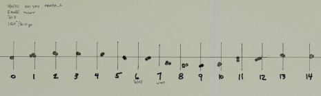

Tuner adjustment on the target
Not much time today. Still cleaning up from the storms Friday night.
It really doesn't matter if the target is this sine test or if it's fired in a match, the group SHAPES still happen in the same progression. The sine test just offers more info to work from, but not needed once tuned for a given load...Maybe more on that later but I've discussed it many, many times on here.
For the context of your question, just look at 10, 11, and 12 on here. Forget everything except group SHAPE! This is EXACTLY what I look for the groups to do, moving MY standard tuner ONE mark at a time.
In this very clear(to me) example, if I get vertical(11), I'd move the tuner IN one mark. If I get 12, I move in two marks. The beauty of the sine test is it shows you how far, which way, top and bottom of swing, as well as mark values and how far between sweet spots. You must establish mark values relative to group shapes or else, you're guessing, no matter what tuner or who it is shooting.
Yessir!!! It IS that predictable too!

I believe I said the same thing to the person that sent me that target! 10-12 show the exact group progression I look for. Like I said before, it's typically about 8 marks between sweet spots.(sr br rifle) So, I would expect to see the poi move up and be back in tune at about 17 or 18. It did this at 2 and at 10 and can be seen on the target....8 marks apart.
I still like Group #14 and would go with that and test repeatability.
And yes I am looking at group shape

I do see #2 has some good elevation/waterline characteristics
Is this what you are looking at? regardless of the spread being bigger than #14?

I don't just look for smallest groups. On it's own, each group is just a single 3 shot group and we all know that one group means nothing, or very little.
I look at POI where it shoots small, followed by group progression as you continue moving the tuner out, how many marks are PREDICTABLY between sweet spots, as well as yes, group size and shape. It's not any ONE of these but a combination of all that confirms the setting. Zero and 14 are both small but neither are at top nor bottom and neither are followed up by the shapes I want to see. Nor are they spaced where they should be. IME, you can tune to spots like 0 and 14 but they will be very tune sensitive and less repeatable.
Tuners change phase time. In very simple terms, they are a tool that allows us to shift the top or bottom of the sine wave left or right to coincide with bullet exit.

I've hit on this point in a few of my last posts. The sine test essentially shows the frequency on target..the distance between nodes...or anti-nodes. This frequency or distance is a constant, generally speaking. So if it's 8 marks between today, it'll be 8 marks tomorrow. Therein lies how simple using one becomes, once you establish factors like how many marks from completely in tune to as bad as it can shoot, ie, anti-node to node, and the respective group shapes between. If there are 8 marks between anti-nodes, there are half of that from anti-node to node, etc...So, 4 marks from in tune to terribly out. So, learn those 4 group shapes!
This is in the competition forum so is based on comp guns and bbl contours. You can do and see the same things on a very good shooting hunting rifle but the predictability from most hunting rifles is just not the same and the results harder to reliably see/read. You mentioned that you shoot only hunting rifles so I thought this might need to be pointed out, for clarity. The more dependable you and your rifle/load are, the more you can rely on the group shapes. Once again I'll say, this is with MY tuner and the examples given are with sr br rifles and bbl contours. Different makes/designs of tuners as well as drastically different contours will give different results. So, you may or may not need to move more than a mark at a time with yours. But frankly, until you know these things in regard to whatever tuner you use, it's guessing...or moving and hoping.

So you're essentially plotting out the sine wave
Right, so half wavelength, and you're determining the amount of marks this coincides with on your tuner then?
And can then more or less pinpoint the
Node

Yessir! You're getting it. It'll shoot small at top and bottom but pc can only happen on the upswing. PC is more important for rf and lr than for sr. For sr, I may very well go with the bottom as shown clearly at marks 10,11 and 12 on the target posted. I may do this for a few reasons...One is that 10-12 are EXACTLY the group shape and poi progression I want and expect to happen. Also, while the groups open more clearly there than say 2-4...that's not a bad thing because, remember, I'm reading my state of tune by group SHAPE. In sr br, I have unlimited sighters and I can see them, so I can tune by them..or check tune.
Now, in rf, where ammo is crap and might have 30-40fps es, or in lr, where every bit of es shows on target without pc, I'd put more emphasis on tuning to the top of bbl swing to utilize whatever pc my rifle and tune will give me. See the difference and the reasoning there?

Again, the groups at 11 and 12 clearly show I need to adjust tune. If I get a group like 12, as the target shows, I'd go IN 2 marks to 10.
I do not advocate changing two things at once. IMO, if you're gonna change anything about the load to maintain tune, don't move the tuner too! At least, not unless you know what to expect. Since any load change could take you to a completely different exit time, hence a different waveform altogether...how would you possibly know that? As to why I might go with the setting where groups progress more clearly as tune goes away, it's just that...because it's clearer. It's like hitting me over the head rather than guessing. There are no wide spots with a tuner. Remember, we're changing a constant so any change should have a corresponding change to group SHAPE. Now, at top in this example, the groups don't open as much but aren't bad but they still show a lack of tune and it's shooting just good enough to lose, particularly in sr. But if you can't see or don't have sighters, the shapes at 2-4 have some merit, ie lr. I just don't like to ever go to the line with a tune that is either hard to read or one that may have me question tune. And to me, the whole purpose of a tuner is two fold. One is to never be out of tune, if I do my part. And two is to maintain absolute peak tune while going pre loaded.
I've done this for years with tens of thousands of rounds in addition to vibration testing. It just seems so easy to me but that sine test is solid freakin gold! It shows you everything you need to know including which way and by how far to move the tuner!
Now some lr tuning, if Clay doesn't mind. ;)
These targets clearly show vertical, just like setting 11 on the sine test target I posted...clear vertical.
So, based on the sine test I'd gi IN 1 mark to get rid of the vertical. See setting 10 and 11 on sine test target. See why, now? Clay has a pretty good handle on using his tuner and his results show that.
Ok so let me guess here
If your groups open up, that is likely an Anti-node (bad spot to tune to)
and you see the groups do the same thing again at say 8 marks out (another Anti-node_)
And if the waveform is always going to be the same and predictable
Meaning going another 8 marks out does the same thing again.
Then, the obvious choice is to try and tune between those at say 4 marks out or in
So the Bad, HIGHLY open groups, when you plot 2 or more of them and they are repeatable
Give more prominent evidence and merely tell you where to set the tuner in between then?
Is this right?
As opposed to looking at only good groups which would make it hard to differentiate which of them is the best choice to pick

Pretty much, yes. The only thing I will point out is that we want to tune to anti-nodes. IE, top or bottom, not middle(node) For discussion's sake, we use the term node often but incorrectly. Doesn't really matter much as long as everyone knows what you mean in regard to a good load/tune.
I think it's coming together more
So I crossed my eyes and fuzzied them like you do with them 3d pictures to make 'em pop out at ya
and I finally see the sine wave pattern
(I was looking at each group individually as opposed to the whole thing like a snake
that was my mistake)
And in Groups 2 and 3 I see them hitting the peak of the sine wave, correct?
Is this PC?
And is this where I would want to tune/experiment with?
Or also the opposite at groups 9&10, the lower extreme of the waveform ?
