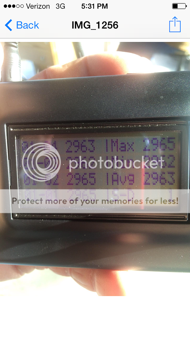

I may get new brass and turn necks down .001 and try that,,but is does shoot well with the 123 Scenar at 2965 with 42.7 H4350 and I cant get pressure with a cram packed case full with that bullet,,do you think I should be able to run the 140 with the case just poured full without getting pressure??I could with the 123 but best accuracy and SD numbers are at 42.7,,
Magnetospeed with 123 Scenar and 42.7 H4350,,made 10 300 yard egg shots in a row last Sunday and the 4 inch swinger at 800 is a really fun target,,
