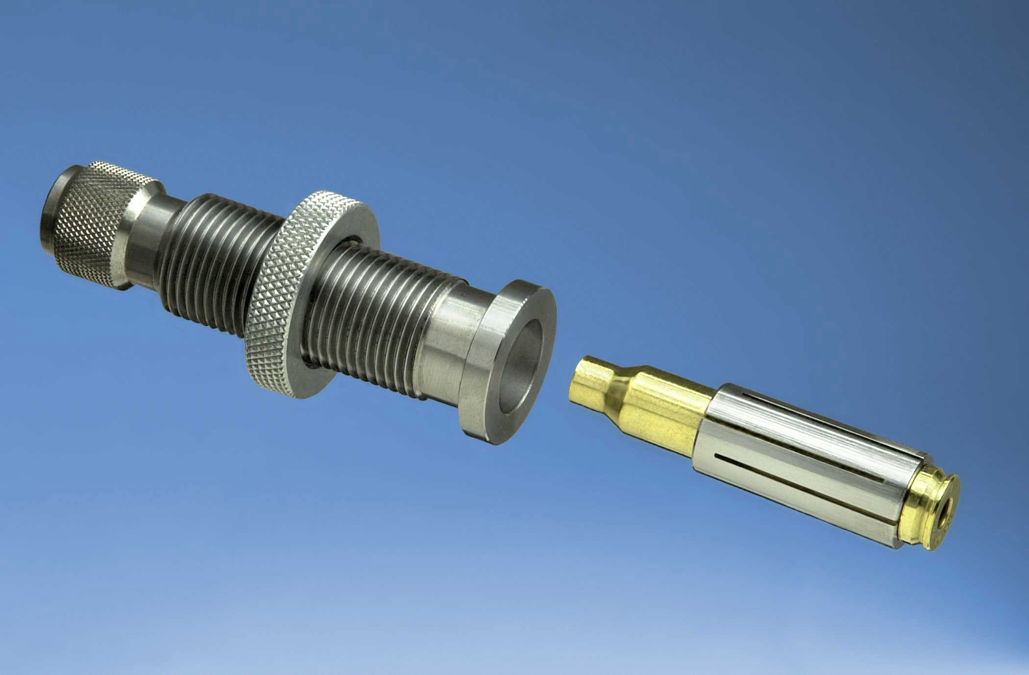

The die below will size the case just above the belt and solve your problem. The majority of belted magnum dies do not and can not size just above the belt. The problem exists because of the variations in chamber diameter and case thickness above the belt. Simply meaning a fat chamber with a skinny case allows the case to expand more above the belt.
And in the photo below the collet slides down to the top of the belt and then squeezes the area that does not get sized with most normal belted sizing dies. Meaning the collet die below acts like a small base die and will reduce the case diameter above the belt.
Belted Magnum Collet Resizing Die

Belted magnum cartridges have been around for over 50 years, and most shooters that reload them are familiar with the case bulge problem that occurs "just above" the belt. This usually happens after just 2 or 3 firings - wasting perfectly good cases. Many shooters have discovered this problem when they find their handloads begin to stick in their chamber, or when they no longer chamber at all.
Unlike non-belted cases, the belt prevents conventional full length dies from traveling far enough down the case. This limits the amount of resizing, and brass is plowed rearward. The brass builds up just above the belt at each reloading, and cases expand. Neck sizing dies don't bump the shoulder back or resize the tapered case wall. The best solution is to full length resize accurately, and use this collet die to reduce case width.
Our patented Belted Magnum Collet Resizing Die solves this problem and has other unique features. The top of this die is a case width gauge that shows when a little "extra" case resizing is required. This resizing die is used to eliminate the case bulge above the belt, after using your full length (or) neck sizing die. Our collet die ensures that your belted magnum ammo will always chamber properly and your cases are now able to last for up to 20 firings, even when using the hottest handloads. Our resizing die uses a collet that fits over the cartridge case, until it bottoms against the belt. The case is then pressed into the sizing die. The collet allows your case to go farther into the die where it only reduces the area "just above" the belt.
This ONE die and collet is universal and works on ALL of the popular belted magnum calibers including: .257 Weatherby Magnum, 6.5 Remington Magnum, .264 Winchester Magnum, .270 Weatherby Magnum, 7 x 61 Sharpe & Hart, 7mm Remington Magnum, 7mm Weatherby Magnum, 7mm STW, .300 H&H Magnum, .300 Winchester Magnum, .300 Weatherby Magnum, .308 Norma Magnum, 8mm Remington Magnum, .338 Winchester Magnum, .340 Weatherby Magnum, .350 Remington Magnum, .358 Norma Magnum, .375 H&H Magnum, .416 Remington Magnum, .458 Winchester Magnum, .458 Lott Magnum and several belted wildcat cartridges. There are no extra collets to buy when resizing different calibers. The U.S. Secret Service was one of our first customers to purchase this product.
This popular collet die is now used by well over 6,000 shooters. Sometimes, the high cost of manufacturing this item requires us to build a waiting list before the next production run is back on the shelf.
Thanks Ed......it probably is the best tool out there , $100.00
