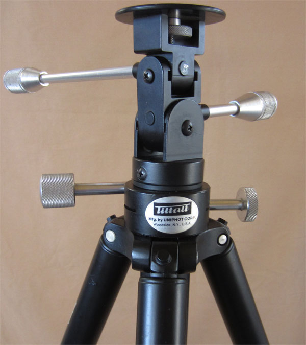

That is a Davidson STAR-D tripod. It is excellent -- all metal with milled aluminum handles, and collet-style low-profile lockers on the legs. This is no longer in production, but it was also produced as the Litz Tiltall (in black finish). You can find these on eBay for $30.00 and up. (But be wary, most of the Davidsons on eBay are the older version -- you want the newer one with the double-hinged head, like the Litz Tiltall).
Once nice feature is that the fittings (event the bolts!) are all machined aluminum so there's almost nothing to rust. This is NOT a super-heavy tripod, but it is still more stable than most portable tripods on the market. The tilt/pan handles also store INSIDE the center tube.

The Davidson Star-D tripod is a solid, all-metal rig that is sturdy enough to be used for movie cameras. Star-Ds feature convenient rotary cam (collet) leg height adjustments and all-metal tilt and pan controls that lock solidly. The center post is clamped with a big locking ring that adjusts for tension. The rugged, machined-aluminum Star-D tripods are no longer in production but you can find good “previously-owned” models for sale on eBay. This tripod is ideal for use with a chronograph or spotting scope (for viewing in sitting or standing positions). You can often pick them up for under $25.00. Look for the latest versions, as shown in the picture.
