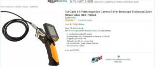

Webster, as I mentioned in my other posting, I don't have the $20 bore scope. I have the one pictured below, so I can't help with details on jpeg capture. But if you can see it on your computer screen all you have to do is use the Snipping Tool utility to do a screen capture. The Snipping Tool is included with Windows 7 and is located in the Accessories folder.
Regarding getting a better image with the cable, I put a black glove over the muzzle to prevent any back light. My borescope allows me to adjust the brightness of the LEDs, I don't know about yours. Looking straight ahead is what you want to do. You can see enough detail (copper, gouges in the rifling, carbon ring, etc...). I have a 90 degree mirror and used it only once, that's because it is like walking around with blinders and looking at your feet. You have no idea where you are, where you've been and where you're going. A real waste of time.
If you're really fixated on the 90 degree mirror, see if the tip of the bore scope has a threaded sleeve. Mine does, if it does then you can look for a 90 degree mirror.
