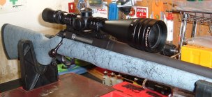

Someone screwed up at the factory and I got a Ruger American Predator in 6.5 Creedmoor and was able to turn down the factory trigger to 2.8# with no issues. Add a B&C fiberglass stock, a Weaver 6.5X20 scope and Nosler 140 gr Acubonds in Lapua cases and that rifle is deadly on Muleys and Goats. Heavier than a stock one but nicer to look at.
