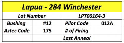

I shoot F-Open so I separate brass in 100 round MTM boxes. Its easy for me to manage the # of firings with this method.
I also created this label in excel. I print it on Avery labels and stick it to the inside of my ammo boxes.
with this method.
