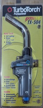

This one works well...Mag-Torch brand also worked well..however Turbo-Torch just seemed to work better.....highly adjustable and consistent flame.
Tried four other torches hooked up to 20# tank and 0-30# regulator...all failed to light or run hot enough. All four worked on 1# bottles.
Turbo is the way to go. As good a flame pattern as it gets. Propane is all you will need, but if you really want to speed things up, MapPro is a hotter flame. If you want to really go fast, you could go with an acetylene / air torch, but you may melt a few cases before you get the speed dialed in LOL
