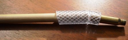

Today I stopped by Lowe's and picked up some braided clear plastic hose 1/2 inch ID (thanks Lapua-40X) and a 1/2 inch diameter wooden dowel. I used a 4 inch piece of the braided hot and pushed it 3 inches onto the 6 inch dowel. So I have the dowel in my hand with my thumb and forefinger putting just a bit of pressure on the braided hose in which I fit the base of the case and it works just fine. Total cost; less than a dollar.

Here is the new improved ergonomic LR Precision Tactical Cartridge Case Anti-Rotation Device. It's not the model with the integrated LED.

And now, in action. The handle fits comfortably in the hand and provides a place for all the fingers to hold on. I only need to apply the tiniest bit of pressure with the thumb to hold the case.
I think I need to apply for a patent. :-)
