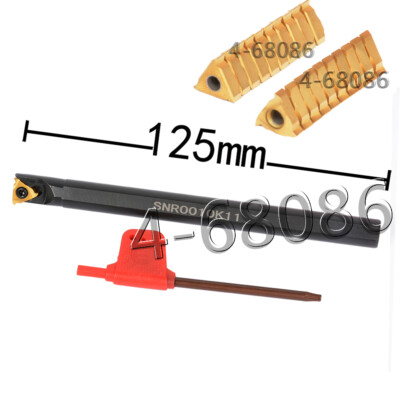

Here ya go man
This is what ya want then
Thanks! I assume the inserts work well for the typical steel that receivers are made of? I've found Kennametal KCU25 carbide inserts work very well for me, but this is a different brand and I'm not sure of what kind of inserts I'd need.
