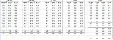

This is exactly what I did. I also messed with the programming so it trickles for 1.0 grains. Mine is really consistent now. I have compared my tuned Chargemaster loads on my Bald Eagle scale and 10 loads fell inside +-.05gr with no overthrows. I think that’s pretty dang good for a ChargeMaster.
Yeah, I'd say +/- .05 is pretty dang good too. The best the CM might do depends a lot on the powder one is using. . . at least that what I've seen in some of my testing.
