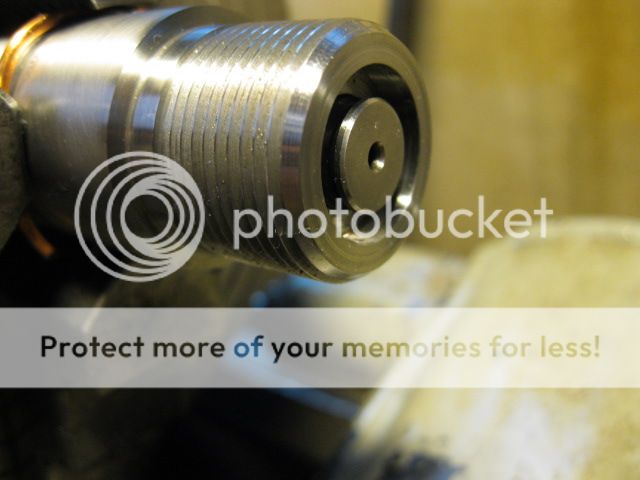

Chambered a 6BRDX for a Stiller TAC30 for one of our members mr.big. I had done a 6.5x47L for him and he wanted to see what all the hoop-la was about. ;)
That looks really nice. The pictures are proof of pride, and you should be. Keep up the good work. We need more people who take pride in their work.

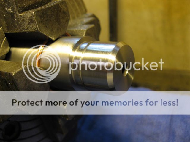

Not a smith but that sure does look sweet. Can I ask about the copper (wire?) Do you clamp on that rather than the barrel and if so doesn't it move/compress, etc in the lathe?
That wire is a very high priority. It serves as a pivot. There is a spider on the other end to allow me to dial a barrel in dead nutz.

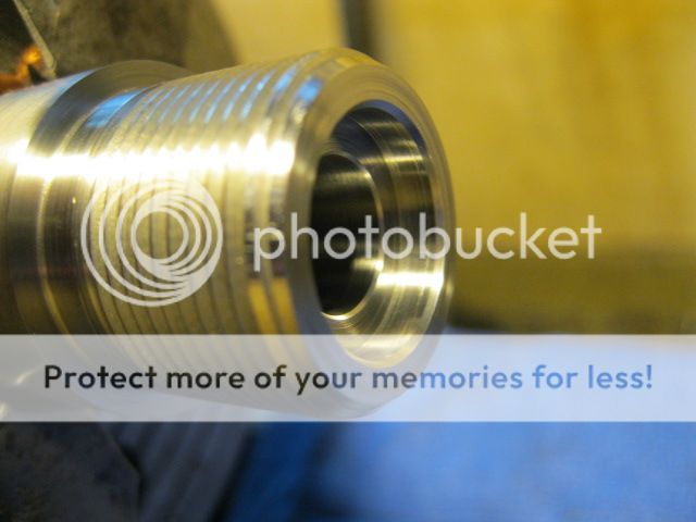

Great work! Very nice finish. What tooling are you using?
Threaded with Arthur Warner HSS, bolt nose recess is with JGS .705" counterbore. I do go behind with some beautification!!
Good deal! AR Warner makes nice stuff. I have their threader, profile tooling, parting tool and a few turning bits. They get used a lot. Plus their shop is about 15 min away if I need anything. :)

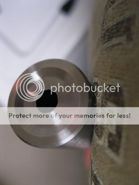

That crown bevel looks a whole lot better than just a straight wall. Nice work on the breech, too. Copper wire is a good idea. Got to be easier than dealing with shim stock.
The copper wire works good. I bored a set of soft jaws for my Buck Set-tru chuck in order to get more surface area on the wire.
