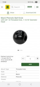

Here is my 2 cents. I have been using a press heater on my point-up press for about 20 years. I have the temp setting to where \\the press body is 95 degrees. It amazed me how the bullet can feel as warm as it does when it comes out of the point-up die when you consider how short of a time period it is in the die. I think my bullets look a bit more shinny and the ogive folds look better and I think it makes the stroke a little slicker. I have only made 30 cal bullets (since 1991). My heater plate looks a little different than the attached link but I did buy it at Midway but 20 years ago. The temp setting is not at the max setting in order to get to 95 degrees.

Wayne could you post some pics of your heater setup
If you search Amazon for "oil pan heater". They come in several different sizes and wattages. They just stick on...

What I like about the heater is that the lube just seems so much more slick than when not heated and the press handle feels smoother during the stroke. This is a cast bullet heater that lead casters use and I got it from Midway about 15 years ago, it has a base plate that is long enough to fit under the point up press. I have talked to others (can't remember who but think it was Rich Griffin that liked the temp of the press to be about 120 degrees. Mine is not that hot I do not think but feels warmer than my forehead.
