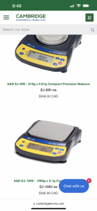

Looking for information from those using digital scales, as to make and model being used. Guys the A&D. EJ & FX models look like they should be good, however the retired lifestyle says not..
Not looking to shot the fly stuff off of the pepper, not doing competition, just getting good start in ELR . What brand or model of digital scale will serve that purpose, for say $ 250.00/ $ 300.00 price range.

It's more than you want to spend, but the A&D FX120i is the gold standard easy button. I've got two of them and use them very often. I'm not totally up to speed on what's out there, but you can spend a lot less, but not really a little less. Last I checked $250-$300 is a bit of a wasteland. I believe (someone correct me if I'm wrong) that this is because hte technology is fundamentally different between the cheap ones and the A&D-tier scales. The cheaper scales are no where near as good as the A&D, but they will get the job done. They drift more, they're slower, and not as precise.
The other upside to the A&D is you can buy an autotrickler as an upgrade in the future if you decide it makes sense for you.
Maybe you can find a used one out there. But I think this is a buy once cry once kind of situation.
All that said, you can make a cheaper scale work just fine (the ones available from the usual reloading companies - RCBS, Dillon, Hornady, etc). My personal best F-TR score (a 598) was shot with ammo loaded with a cheap digital scale. The cheapos are basically all the same in my experience.
Long story short, I'd spend $50 or $500, not $250.

Check out US Solid. In my experience scales marketed for reloading aren't as accurate as an analytical balance/lab scale. I have this one and love it, but they have them in many price ranges.

Would you mind giving us an example of a moderately priced electronic scale that has thermal drift compensation? I would consider the FX120 a high end scale.
