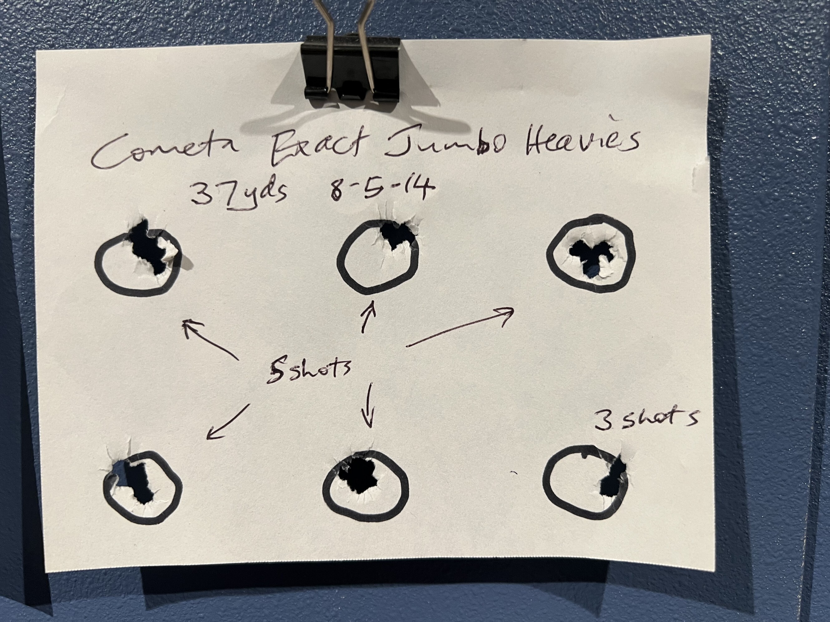

FX is also a very nice platform, this is a group at 75 yards my son shot of a xbag a while ago with a 4.5mm FX Cutlas and a little leapers scope. He has taken pest birds out past 100y with it.
