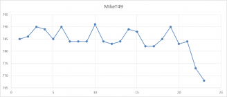

My SCUBA tank is down to 2400 psi. Need to take it downstairs and refill. In the meantime, I ran a string starting with a 2400 psi fill. There are probably 5 more shots on the curve with a 2500 psi start.
Here ya go: 785, 786,790, 789, 785, 790, 784, 784, 784,791, 784, 783, 784, 789, 788, 782, 782, 785, 790, 783, 784, 773, 768. This with .177 cal, 16.2 grain JSB.Exact Beasts. So, about 25 shots on the flat spot with this tune.
I would stop at shot 21.
