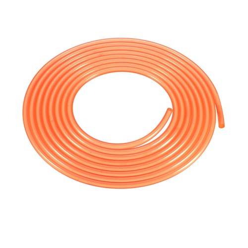

This is an ancient thread, but I wanted to point out that you can make any size belt you want from bulk urethane belting. Unless a local discount store stocks the Eureka belts, you're likely to have to pay $15 for a belt to be shipped to you regardless of whether you go with an EDPM O ring or a Eureka vacuum belt. As of Dec 2022 a 10 ft length of 3/16" dia (5 mm) urethane belt costs $9.60 on ebay:
If anybody's interested, comment on the thread and I'll post how the belt making goes. I drilled out the three spot welds for the motor bracket on my Thumler's Tumbler yesterday (3/16" drill bit is the right size) and slotted the holes so I can move the motor to adjust for belt size / tension.

I don't think the original poster was ever able to determine why the factory belts were breaking for him, but he solved the problem with an EDPM O ring which is working better than the official ones he had been using. My tumbler came from a yard/estate sale and was missing the belt. I've made do for a few years with various large O rings and sewing machine belts of unknown identity just because I had them around the shop. They worked but they all eventually stretched and let me down. You can't beat the convenience of buying a factory replacement belt and you're assured that they're going to fit, but they aren't a custom made belt; they're a standard O ring. The O ring the original poster bought seems to be more durable than a factory belt and that appeals to me. Bayou's follow up post about durabililty is here:
I couldn't get Thumlers belts or O rings for less than around $15 when you add in the shipping. I had read about making urethane belts on another forum so I considered that option and it turned out to be cheaper. For about 20 years I had a urethane belt driving the table feed on my Hardinge horizontal mill so I was familiar with urethane belt durability. Having had to replace the tires on my band saw a year or so ago, I was familiar with how urethane doesn't like to stretch. Youtube is replete with videos on how to join urethane belts (easy). I like tinkering and making my own things, so I went that route. I wouldn't disagree with those who like to shoot more than tinker.

The urethane belting arrived today so as promised, here's my writeup of making a belt.
I didn't have an official belt to work with to know what size to make it, so I wrapped the belt around the pulleys and let that be my guide. Initially I allowed an extra 1/4" for the squeeze out that would occur with the hot joining. This turned out to be too much. The belt is stiff so it isn't tight around the small pulley when you do this and that outward bowing of the belt is adding the extra slack you'll need for the heating. In the end the belt was about 12.5" in length. I cut the belt to length with wire cutters. You could probably do it with a knife.
