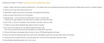

The capacity of your tumbler is 15 pounds. I have the STM unit that has a 17 pound capacity. Reduce these amounts slightly for the less capacity you have. Much different that most other folks recommended already. You decide which to try.
Brass about 50% full, a bunch of stainless chips, not pins (the pins I had fit perfectly in a 6mm neck, PITA to get out) squirt of Dawn, shake of Lemishine, hot water to 3/4 full. About 45 minutes is all you need for clean shiny brass.
