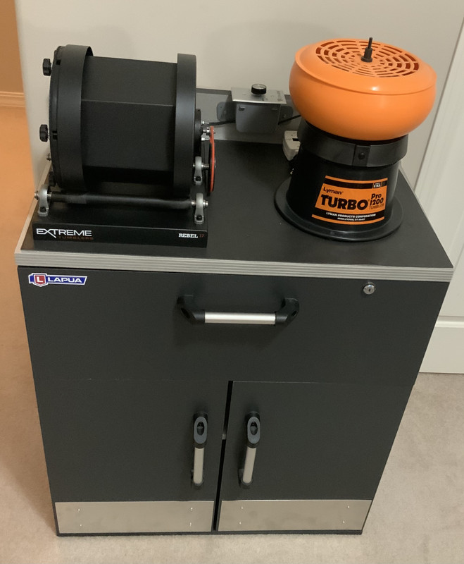

I had a Thumler’s for 5 years. Nothing wrong with it, but I bought one of these…(on the left)
It does the same great job as the Thumler‘s. You can’t go wrong with wet tumbling IMHO. I use 5 pounds of stainless steel pins, fill to about an inch below full. Add a couple of healthy squirts of Dawn and a 9mm case full of “Lemi Shine” (citric acid). An hour and a half to two hours, and basically you have new brass. Sometimes, you will get a pin or two stuck in a flash hole. Easily pushed through with a paper clip. And, I do rinse after the cases exit the tumlber. I use a drying tray to air dry, usually overnight.

What do you like about the Extreme tumbler over the Thumler?
Nothing really. It’s supposed to have more capacity capability because of the roller bearings used. I found the Thumler’s unit to have a better drum unit. The Extreme unit’s drum was not true and tended to wobble a bit while in motion. Also, the lid didn’t seal like the Thumler’s lid. So I had to use 2 gaskets to seal it. It seeped a lot with just one gasket. And btw, those screw threads on the lid are metric(?). Whose idea was that?
The Extreme‘s motor rotates faster. I thought it would be a problem, so I installed a variable resistor to slow it down. In hindsight, it wasn’t an issue at all.
Over all, the Extreme works as well as the Thumler’s. If I had to do it over again, I would probably have kept the Thumler’s unit and not bothered trying to massage the Extreme to get it to work as well as the Thumler’s unit.
