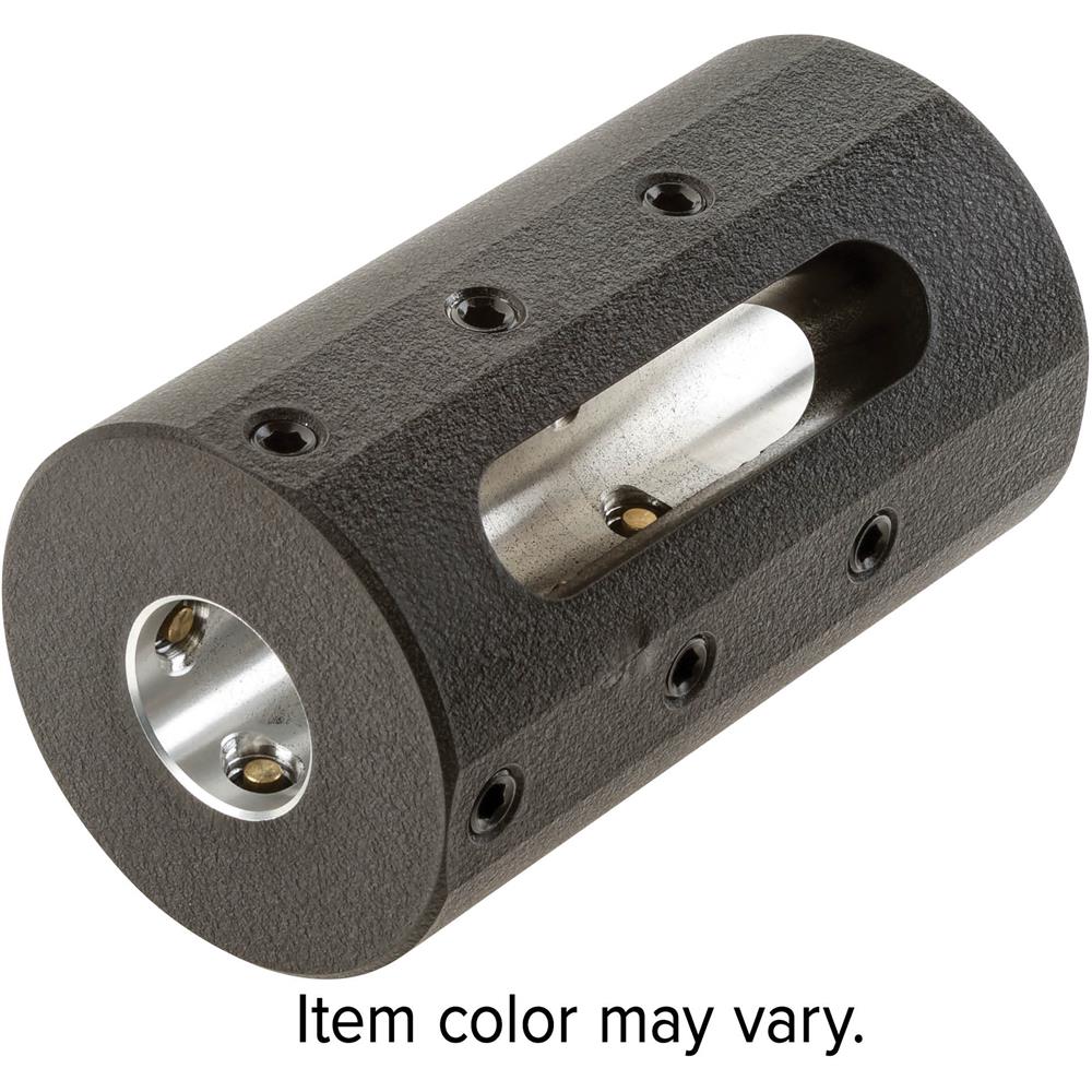

This was a short 16.5" barrel, so I used a Viper fixture in a 4 Jaw.
