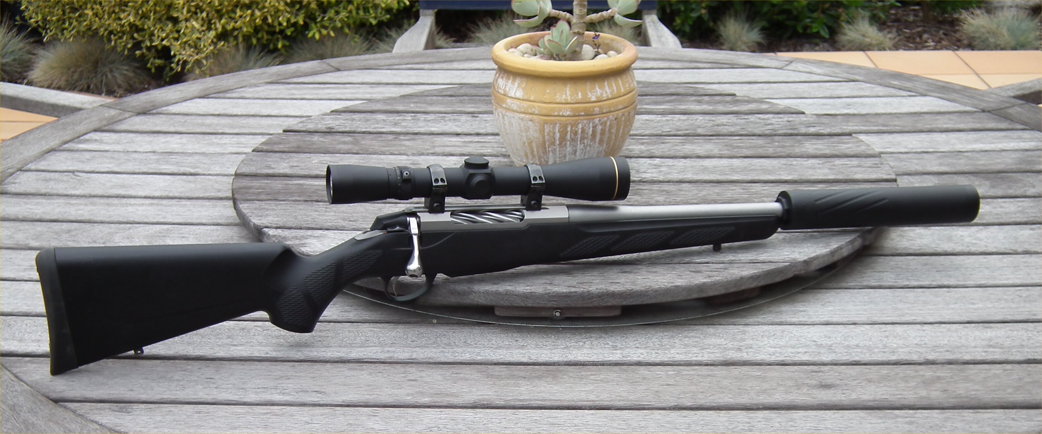

Much of the velocity loss with shortening barrels can be overcome with intelligent loading.
Here is my 7-08 Tikka with a 16" bbl. It deliver a 120TTSX (equivalent to a 140 lead bullet) at 2940 and that thing kills deer very well out to 300yds, further at times. It is very light and useable in tight bush, something we have plenty of here.
Chris, with those over the barrel suppressors, is there a tight bushing the rear of the suppressor slides over on the barrel or is it just supported by the threaded attachment/shoulder in the middle of the can? Something about that design appeals to me.

There is normally a delrin bush at the rear.you don't want it tight.its basically there to help align the threads when fitting and if it comes loose it can keep it inline with the bore to a degree.you can use it without the bushing,it's the shoulders on the barrel and suppressor that need to be correct..square to the bore.

No, it is critical the rear bush does NOT contact the barrel or else you will get a variable zero each time you refit it. The rear bush is only to protect the barrel thread in the event of a big impact. The alignment of the can relative to the barrel axis is determined by the contact on the shoulder.
