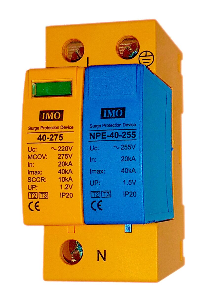

Not knocking your choice of surge protection but MOST don't clean the incoming power.
Large fast spikes are shorted out, usually rated in JOULES.
Voltage swings, brownouts, RF noise floating on the house wiring requires a "conditioner" or UPS.
Still a good thing to have though.
Rocketvapor nailed it. My background is aircraft electrical power. We see significant spikes, conducted disruptions and radiated electromagnetic fields. Airplanes are a nasty environment and equipment has to be hardened against severe threats. The worst are HIRF (High Intensity Radiated FIeld) and EMP (Electromagnetic Pulse). EMP is tricky since the threat levels are classified. Tough to design against something you can't quantify. Fortunately, most of these threats aren't present in a home. Good thing, because the electronics we have at home aren't hardened against those threats.
Surge suppressors may protect you against a lightning strike on ac power lines. Typically they contain a cheap MOV (metal oxide varistor). MOVs are sloppy protectors that clamp voltage spikes; possibly not well enough to protect your equipment. Note that they are supposed to protect, not stabilize.
To stabilize, you need something that approximates a battery. Smooth dc voltage and minimal electric and magnetic fields. A good power conditioner can do that. Then figure out if your environment is clean enough. It's easy to figure out if your lights, cell phone, audio speakers, laptop or whatever is affecting something else. Just separate them or turn off the suspected device and look for the effects. There are lots of "old wives tales" about interfering equipment. Most often it's from folks who repeat anecdotes. It can happen, though. By way of example, when I bought a Creedmoor scale I put it next to my Chargemaster Lite for comparison. They did not agree with each other and were inconsistent to boot. I was looking for a cross-check and unpleasantly surprised. By separating them by a foot or so, the issue went away. Just like arguing children - move them out of earshot of each other.
Surge suppressors can be useful, but they're not a panacea. Be sure they're UL or ETL listed. You might have radiated or conducted interference in your house; probably not. I suggest some simple tests to figure out if you have gremlins or not. Don't just buy a surge suppressor and expect results.
