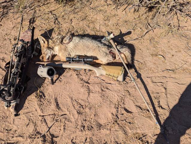

My varmint gun Anschutz 1740 in 222. One for the range and one for the field. What’s not to love about the Duece??
