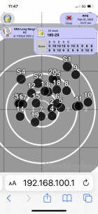

- 185 2x target: appears to show the centre of the group was high and right. lowering and moving left may have gained you a point or two. Here you shot two sighters (S1-S4) on both sides of the X ring. Were they different values or holds.

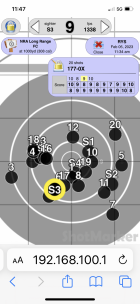

- 177 - 0x: appears to be a head / tail wind relay. If that was the case put your rifle on ZERO and shoot your sighters in both wind flag directions to see your wind bracket. Also note head / tail wind relays produce more vertical and will need you to adjust your aiming point depending on the direction of the wind ((high) left to right) and ((low) right to left).
