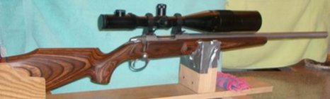

Put a bill in that half box...I'll square up with you...I did 100 WCC 03 tonight..I'm taking those primed cases to the range with my measure, powder, press & seating die...this will work out..I'll find the best load faster & with less waste...I'm in uncharted waters here..not much info on the 20 tac...That & I've never range loaded before..This should be fun...The New Used Nightforce 8 x 32 in talley QD mounts [thanks to don at long range supply.. used scope, factory dated inspection sticker 4-11-06 looks new]is on the clean bedded Sako varmint sporting a Pac-nor 1 in 11 twist barrel...The trigger on that gun is sweet..I'm sure this thing is going to one hole group on its first outing...well maybe not one hole..but a decent group...I waited a long time for this rig...mike in ct
Take a look...thanks for all the help here...you guys are great, mike in ct
