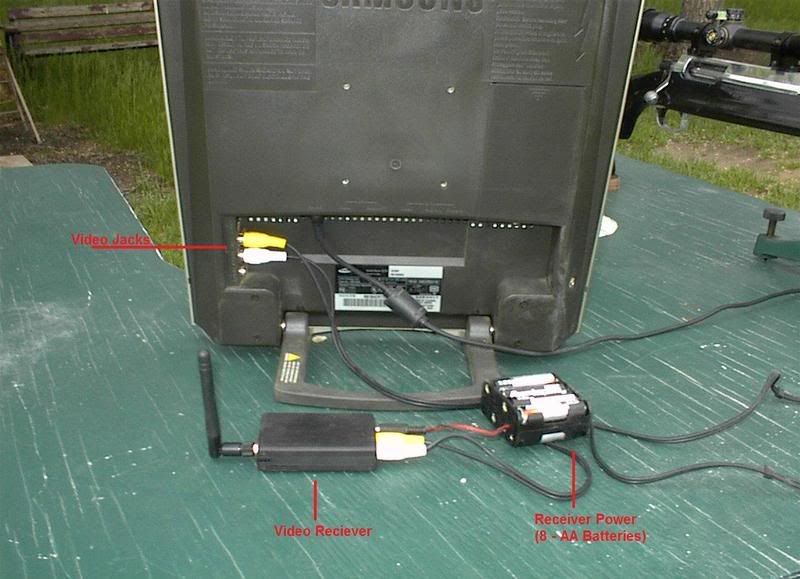

Not sure what your all hoping to accomplish with your drone and Apple miniPad, but for "live viewing" from my experience the bigger the monitor the better. I have had my setup on a 9", 11" 15.7" and 21" and can honestly say for 1000yd target viewing "bigger is better" bar none.
Here is a IBS-1000 target being received on a 15.7" Samsung panel:
Here is the RC receiver, battery pack and cables:
That transmitter & receiver cost me $169, and have used it to 3/4-mile (no doubt would work further yet) with no high-gain.
With a high-gain antennae they claim up to +4-miles.
My 2-Cents
My 2-Cents
Donovan

Now that you have done all the work, it would be great if you would list all the components you would buy today to set up a camera system up to 1000 yd
I'll second that request! Donovan, your setup looks perfect.
