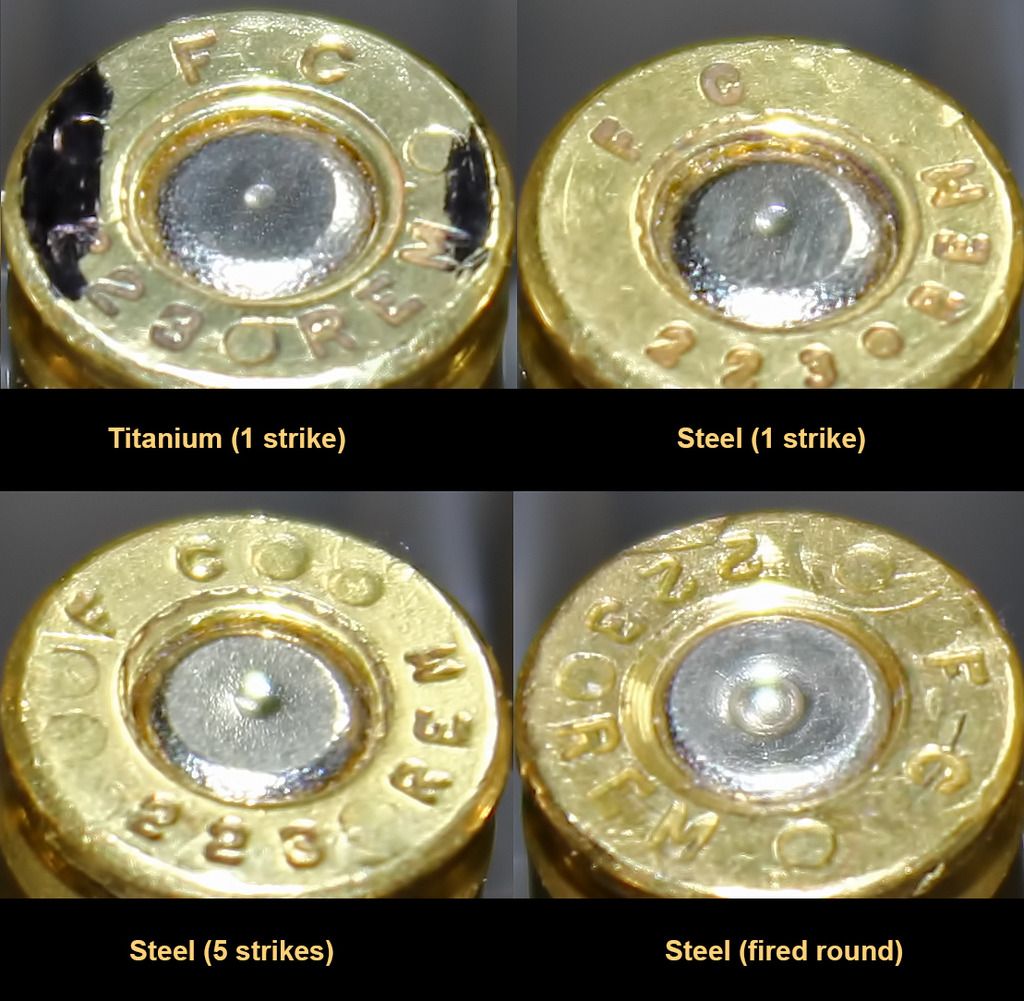

Yes, you may have to be concerned with an AR-15. The firing pin is free floating and contacts the primer when you chamber a round. Here is a test with Federal primers. I chambered a few rounds letting the bolt slam as you normally would. I now use a titanium firing pin for an added measure of safety. It makes much less of an indentation compared to the stock steel pin. Rechambering the same round 5 times increased the size of the dent. Don't know if one could ever go off if somehow the same round was chambered and then taken out not fired and reused later. If the Winchester has a thinner cup, it may be possible.
It can happen, at least with the very early M16. Many years back a retired British Army ordnance officer wrote a series of illustrated articles about his experiences of investigating firearms and ammunition blow-ups in the long defunct British 'Guns Review' magazine.
One case he investigated was somewhere in the far east where British soldiers patrolling an area for insurgents were issued with US M16s on a trial basis. On leaving camp one day, an experienced non-com had an inexplicable ND as he charged the weapon. This was found to be caused by chambering a round at the start of a patrol, unloading it at the end and replacing it in the magazine top position ... to have the same thing happen again and again on subsequent outings until finally there was a great enough indentation on chambering to cause the round to fire. The effect was replicated in controlled trials. After that an instruction was issued to ensure a fresh cartridge was always the first to be chambered and that the muzzle should be pointed at the ground on chambering it. I don't suppose this incident helped the Colt sales team much in trying to sell the rifle to the UK. (A later set of 'black marks for the M16A1 and its M193 55gn bullet ammunition was British Special Forces experience with them in the early 1980s Falklands war where several well aimed shots produced hits with minimal wounding / stopping effects on Argentinian defenders.)
