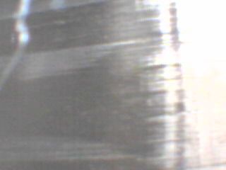

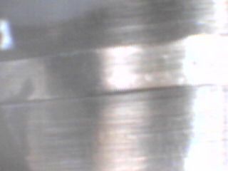

I really thought my barrel was clean. I clean after every range session. I was shocked what came out short stroking that throat. As you can see from the pics the begining of.the lands were getting buried in carbon. Now that is in a new barrel with maybe 200 rounds through it. I can imagine what it.would look like after 600. Since that is the first.place that the bullet engages the rifling it seems to me having the begining of the lands buried in carbon is not conducive to accuracy.
As you can see from the before and after cleaning made quite a difference.
