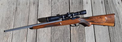

Got the Leupold VX III 6.5-20x40 with VHR varmint reticle scope mounted...
