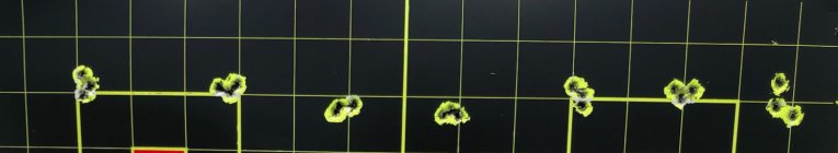

I made myself a new barrel for my Kauger. I realized the 7 twist was way over spinning the bullets at the speeds are shooting.
Here is the first workup from the break in.
This is ts15 5 starting at 29.6 in .3 jumps to 31.4. Velocity went from 2955 to 3146. 75 ELDM. Jumping 15 thou.
30.2 and 30.5 had spreads of nearly nothing . Ones and twos. 3050ish.
Perks over 22bra vs 223 ai vs 22xc. Seems like a better choice than the 22xc though i love it.

Just do the rpm math 320k is 3100 RPM with a 7 twist.
You want to be closer to 280k to 290k.
The bullet really doesn't matter. It's just rpms.

I've really enjoyed working out the bugs in the 22 bra. Really there weren't any bugs to work out other than I made the wrong twist barrel. And because I make my own barrels I didn't really mind all the wasted bullets it was a good learning experience. I came out of the other side of 4 or 500 rounds of frustration with a bunch of new knowledge. So now I know what to tell my customers.
I think I'm going to make a 22XC 170 free bore and compare it directly to the 22 bra 150 fb after I get some more groups.
