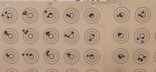

Here is the load workup with the 80 grain Sierra MatchKing. The powder is reloader 16 and the primer is the CCI 450. This is fire formed Lapua brass. The bullet was seated 20 thou into the lands. I do not think that is a good seating depth for this bullet. I definitely think it's going to shoot way smaller with a different seating depth and I'll do the seating depth test next. There are several good nodes but I want to do the seating depth test next and then revisit this entire test once again.20230603_161638.jpg20230603_161008.jpg
Not criticizing at all... what made you choose 0.5gr steps? I would have probably done .4 or .3 ... so I'm second guessing what I would have done if it were me.
Rough test first. Needed to start low and go all the way up. I have no frame of reference on this cartridge.
Next will pick a node and focus on an area in smaller steps.
