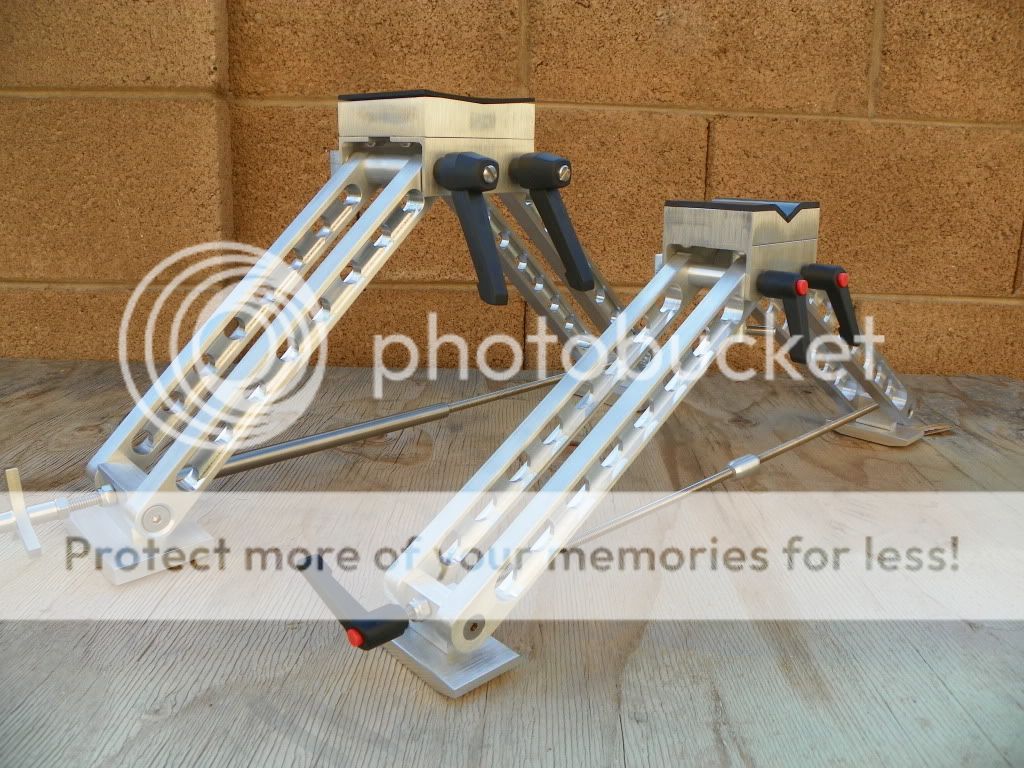

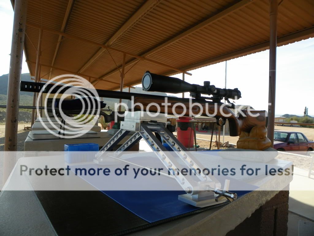

Tha bipod I made myself and have had soo many people ask me about it I am making some more, just a little smaller than that. I made that one out of material I had laying around and it weighs 7 lbs. I just finished a light weight prototype that weighs 2lbs 14 ounces for guys that shoot F class. I have to go to work right now but will post a pic in the morning. I have some parts in different stages of machining and hope to get them assembled in a couple weeks. Way cheaper than the other bipods on the market. The only problem is I make all the parts myself so it takes some time.

I can stand on them and I weigh 206

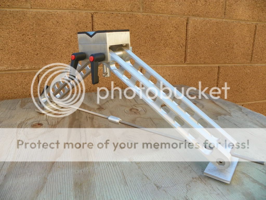

Here is the original and the light weight prototype for F Class shooters.
I originally just built one for testing loads because they are so sturdy, but a couple of the guys at the range wanted me to make them one. And then a guy wanted to see if I could make one less then 4 lbs for him to shoot F class with. I also have a middle size that is good for the shooter that doesn't need to make weight and just has fun with it like me. I sold the only one of those that I have finished at this time.
So this is the first light weight one I did so far and it weighs 2 lbs. 14 ozs.
I was thinking of making the adjusting handle in the middle of the adjusting rod so it is easier to get to if you are shooting laying prone.
I only have a Bridgeport to make them on so it takes a while. I didn't want to post about them till I have a couple made to sell. I use stainless hardware on them and thay have a brushed aluminum finish. I am going to ask $150. plus shipping. If you only knew how long it takes to machine the parts you would know I couldn't do this for a living. I do it because I like it and they are one of a kind made in the good old USA. Hope that doesn't sound too korny.

If you are interested in one shoot me a PM and I can put your name on a list. I have 1 name on the list so far and enough material in the works to complete 4 middle size ones and 4 light weight ones. You have to be patient, I'm just a guy doing this in his spare time.
