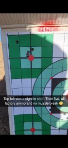

Was finally able to sight in my 22" 7mm prc build. After having issues sighting in i removed the Ec tuner brake. I got the following group. Now time to see if my muzzle threads are not aligned properly with the bore or what is going on. This was factory 180gr eldm
