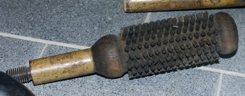

We would clean the bore with Hoppes #9 (in 5 gallon cans) with a bronze brush on a segmented pole (cleaning rod). This usually took at least 2 crew members to work the brush. Finally swab out with a rag like a t shirt.

The M256 120 MM tank gun has a chrome lined bore, we pretty much cleaned it the same way as we did on the M68 68A1s 105 mm on the M60 series and early M1 M1IPs. Usually we had a dedicated team (company level, occasionally, the battalion) to pull the ramrod, with a guy in the turret to catch the brush and goo, then chuck the brush out to run it through again. Another team check checked tracks, oil ect. Made it faster than everyone struggling to do everything on their own tank.
