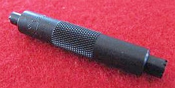

On all my Lapua brass, I leave the primer pockets totally alone and clean only with the Dewey Crocogator. It gets the majority of the debris out and usually after tumbling the pockets are almost totally cleaned up. Winchester and other domestic brass i used to uniform the primer pockets and had every tool known to reloaders to uniform and clean primer pockets. Can't say it made any difference one way or another but as already said, "it made me feel good" ;) But after gravitating to lapua brass and this site I pretty much only use lapua brass and have about shelved all the other calibers I used to shoot because of the lack of quality brass. If plannig a new rifle build I go to the lapua brass chart and go from there.
Frank
40X Guy said:
On all my Lapua brass, I leave the primer pockets totally alone and clean only with the Dewey Crocogator. It gets the majority of the debris out and usually after tumbling the pockets are almost totally cleaned up. --Frank
+1 . This is my procedure. I like the Crocogator because it is virtually indestructible, goes in square, and is double-ended so it works on large/small primer pockets. I used to use an RCBS wire brush tool, but after some use, some of the bristles broke/bent, so it was more awkward to use. The crocogator will also fit inside a plastic film canister along with my caliper-mounted comparator for measuring shoulder bump!
Gotta get me one of these!!
